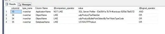

I have put in place a server side trace with the following filters: (this is part of the script)
-- Set the Filters
declare @intfilter int
declare @bigintfilter bigint
exec sp_trace_setfilter @TraceID, 10, 0, 7, N'SQL Server Profiler - 53e0541a-7b74-4fce-bcac-9255e79a6372'
exec sp_trace_setfilter @TraceID, 34, 1, 6, N'udpProductTaxRateGet'
exec sp_trace_setfilter @TraceID, 34, 1, 6, N'udpProductBulletPointSelectByTier1NoteTypeCode'
exec sp_trace_setfilter @TraceID, 35, 1, 6, N'US16AUTPProduct'
-- Set the trace status to start
exec sp_trace_setstatus @TraceID, 1
-- display trace id for future references
select TraceID=@TraceID
When I run this query now, I can see what columns are there, and exactly how the filters would work.
-- what filters are set on @traceid
-- and how they are working
-- marcelo miorelli sql server 2005 - 8-8-2016
declare @traceid int
select @traceid = 2
select a.[columnid]
     ,c.[type_name]
     ,c.[name] as [Column Name]
     ,[ @comparison_operator ] = CASE A.comparison_operator
                                     WHEN 0 THEN '= (Equal)'
                                     WHEN 1 THEN '<> (Not Equal)'
                                     WHEN 2 THEN '> (Greater Than)'
                                     WHEN 3 THEN '< (Less Than)'
                                     WHEN 4 THEN '>= (Greater Than Or Equal)'
                                     WHEN 5 THEN '<= (Less Than Or Equal)'
                                     WHEN 6 THEN 'LIKE'
                                     WHEN 7 THEN 'NOT LIKE'
                                     ELSE 'NOT SURE'
                               END
     ,a.value
     ,[ @logical_operator ]    = CASE A.LOGICAL_OPERATOR
                                     WHEN  1 THEN 'OR'
                                     ELSE         'AND'
                                 END
 from fn_trace_getfilterinfo( @traceid ) a
    INNER JOIN sys.trace_columns AS c ON a.ColumnID = c.Trace_Column_ID
--[ @logical_operator = ] logical_operator
--Specifies whether the AND (0) or OR (1) operator is applied.
--logical_operator is int, with no default.

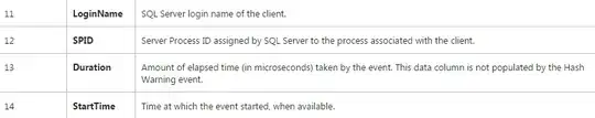

First of all remember that traces and profiler have been deprecated and you should really be looking at Extended Events. None of the information you are looking for is in system views (that I know of) but it is in Books on Line. First look at the format of sp_trace_setfilter
sp_trace_setfilter [ @traceid = ] trace_id
, [ @columnid = ] column_id
, [ @logical_operator = ] logical_operator
, [ @comparison_operator = ] comparison_operator
, [ @value = ] value
The @columnid column is the one you are concerned with but you also want to look at the @logical_operator and the @comparison_operator.
The information on the @columnids possible is found in the BOL entry for sp_trace_setevent.
sp_trace_setevent [ @traceid = ] trace_id
, [ @eventid = ] event_id
, [ @on = ] on
There is a whole tables of possible @eventids and @columnids (what you are looking for).
Here is a brief example of some of the data in the @columnid table including #13:
