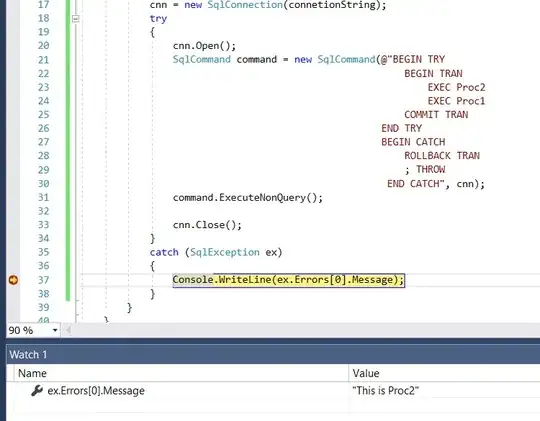

Did you try to catch SqlException in C# code?
Below is my example:
SQL Code:

.NET code:
try
    cnn.Open();
    SqlCommand command = new SqlCommand(@"BEGIN TRY
                                            BEGIN TRAN
                                                EXEC Proc2
                                                EXEC Proc1
                                            COMMIT TRAN
                                        END TRY
                                        BEGIN CATCH
                                            ROLLBACK TRAN
                                            ; THROW
                                         END CATCH", cnn);
    command.ExecuteNonQuery();
    cnn.Close();
catch (SqlException ex)
    Console.WriteLine(ex.Errors[0].Message);
RESULT:
