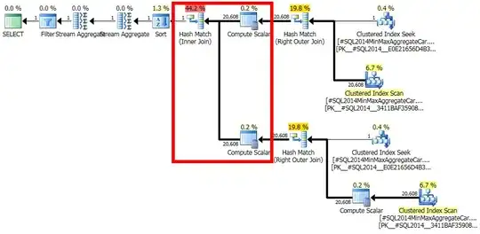

Consider the following query plan in SQL Server 2014:
In the query plan, a self-join ar.fId = ar.fId yields an estimate of 1 row. However, this is a logically inconsistent estimate: ar has 20,608 rows and just one distinct value of fId (accurately reflected in the statistics). Therefore, this join produces the full cross product of rows (~424MM rows), causing the query to run for several hours.
I am having a hard time understanding why SQL Server would come up with an estimate that can be so easily proven to be inconsistent with the statistics. Any ideas?
Initial investigation and additional detail
Based on Paul's answer here, it seems like both the SQL 2012 and SQL 2014 heuristics for estimating join cardinality should easily handle a situation where two identical histograms need to be compared.
I started with output from trace flag 2363, but was not able to understand that easily. Does the following snippet mean that SQL Server is comparing histograms for fId and bId in order to estimate the selectivity of a join that uses only fId? If so, that would obviously not be correct. Or am I misreading the trace flag output?
Plan for computation:
  CSelCalcExpressionComparedToExpression( QCOL: [ar].fId x_cmpEq QCOL: [ar].fId )
Loaded histogram for column QCOL: [ar].bId from stats with id 3
Loaded histogram for column QCOL: [ar].fId from stats with id 1
Selectivity: 0
Note that I have come up with several workarounds, which are include in the full repro script and bring this query down to milliseconds. This question is focused on understanding the behavior, how to avoid it in future queries, and determining whether it is a bug that should be filed with Microsoft.
Here is a full repro script, here is the full output from trace flag 2363, and here is the query and table definitions in case you want to quickly look at them without opening the full script:
Consistency
There is no general guarantee of consistency. Estimates may be calculated on different (but logically equivalent) subtrees at different times, using different statistical methods.
There is nothing wrong with the logic that says joining those two identical subtrees ought to produce a cross product, but there is equally nothing to say that choice of reasoning is more sound than any other.

Bug?
Now, as noted in the question, in this case the 'simple' single-column join (on fId) uses the CSelCalcExpressionComparedToExpression calculator:
CSelCalcExpressionComparedToExpression [ar].fId x_cmpEq [ar].fId
Loaded histogram for column QCOL: [ar].bId from stats with id 2 Loaded histogram for column QCOL: [ar].fId from stats with id 1
Selectivity: 0
This calculation assesses that joining the 20,608 rows with the 1 filtered row will have a zero selectivity: no rows will match (reported as one row in final plans). Is this wrong? Yes, probably there is a bug in the new CE here. One could argue that 1 row will match all rows or none, so the result might be reasonable, but there is reason to believe otherwise.
The details are actually rather tricky, but the expectation for the estimate to be based on unfiltered fId histograms, modified by the selectivity of the filter, giving 20608 * 20608 * 4.85248e-005 = 20608 rows is very reasonable.

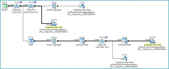

Following this calculation would mean using the calculator CSelCalcSimpleJoinWithDistinctCounts instead of CSelCalcExpressionComparedToExpression. There is no documented way to do this, but if you are curious, you can enable undocumented trace flag 9479:
9479 plan
Note the final join produces 20,608 rows from two single-row inputs, but that should not be a surprise. It is the same plan produced by the original CE under TF 9481.
I mentioned the details are tricky (and time-consuming to investigate), but as far as I can tell, the root cause of the problem is related to the predicate rId = 508, with a zero selectivity. This zero estimate is raised to one row in the normal way, which appears to contribute to the zero selectivity estimate at the join in question when it accounts for lower predicates in the input tree (hence loading statistics for bId).

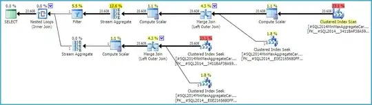

Allowing the outer join to keep a zero-row inner-side estimate (instead of raising to one row) (so all outer rows qualify) gives a 'bug-free' join estimation with either calculator. If you're interested in exploring this, the undocumented trace flag is 9473 (alone):
9473 plan
