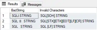

If you're like me and you've gotten tired over the years searching for these characters in your company's terrible data, you can use this function or rewrite it for your own purpose. It's admittedly wordy, but it goes the extra step of identifying special characters if you want - uncomment lines 19 - 179 to do so.
If the string does not contain non-printable or extended ascii values - it returns NULL.

And then, call it like:
SELECT BadString, dbo.Find_Invalid_Chars(BadString) [Invalid Characters]
FROM #tmp_Table tmp_mc
WHERE dbo.Find_Invalid_Chars(BadString) IS NOT NULL
Sample Output:
With Char Identity
Or
Without Char Identity
John
  • 747
    This is brilliant! Probably not as efficient as the accepted answer for finding rows with bad data, but once found this is perfect for analysing what specifically is bad. Thanks so much for sharing. – Ian McGowan Sep 11 '21 at 19:06
  • How does it "work" since you've commented out all the code? – Fandango68 Nov 22 '21 at 03:30
    @fandango68 "it goes the extra step of identifying special characters if you want - uncomment lines 19 - 179 to do so." – John Dec 05 '21 at 19:34
  • Thanks John. So if I want to id all those special chars, I uncomment all the code? – Fandango68 Dec 06 '21 at 03:51
    @Fandango68, that's correct. If you highlight all that code in SSMS and hit CTRL-K, CTRL-U it will uncomment all those lines at the same time. CTRL-K, CTRL-C will comment them back. – John Dec 07 '21 at 21:02
