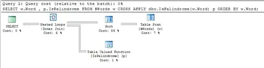

Multi-statement TVF:
Table '#A1CE04C3'. Scan count 16896, logical reads 16900, physical reads 0, read-ahead reads 0, lob logical reads 0, lob physical reads 0, lob read-ahead reads 0.
Table 'Worktable'. Scan count 0, logical reads 0, physical reads 0, read-ahead reads 0, lob logical reads 0, lob physical reads 0, lob read-ahead reads 0.
Table '#Words'. Scan count 1, logical reads 88, physical reads 0, read-ahead reads 0, lob logical reads 0, lob physical reads 0, lob read-ahead reads 0.
SQL Server Execution Times:
CPU time = 1700 ms, elapsed time = 2022 ms.
SQL Server parse and compile time:
CPU time = 0 ms, elapsed time = 0 ms.

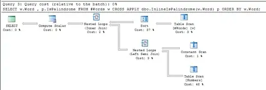

Inline TVF:
Table 'Numbers'. Scan count 1, logical reads 1272030, physical reads 0, read-ahead reads 0, lob logical reads 0, lob physical reads 0, lob read-ahead reads 0.
CPU time = 137874 ms, elapsed time = 139415 ms.

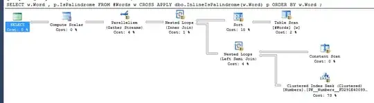

The execution plans look like:
Why is the inline variant so much slower than the multi-statement variant, in this case?

As @MartinSmith suggested, I've added a primary key and clustered index to the dbo.Numbers table, which certainly helps and would be closer to what one would expect to see in a production environment.
Re-running the tests above now results in the following stats:

CROSS APPLY dbo.InlineIsPalindrome(w.Word) p:
(17424 row(s) affected)
Table 'Numbers'. Scan count 1, logical reads 237100, physical reads 0, read-ahead reads 0, lob logical reads 0, lob physical reads 0, lob read-ahead reads 0.
Table '#Words'. Scan count 1, logical reads 90, physical reads 0, read-ahead reads 0, lob logical reads 0, lob physical reads 0, lob read-ahead reads 0.
CPU time = 17737 ms, elapsed time = 17946 ms.

Your numbers table is a heap and is potentially being fully scanned each time.
Add a clustered primary key on Number and try the following with a forceseek hint to get the desired seek.
As far as I can tell this hint is needed as SQL Server just estimates that 27% of the table will match the predicate (30% for the <= and reduced down to 27% by the <>). And therefore that it will only have to read 3-4 rows before finding one that matches and it can exit the semi join. So the scan option is costed very cheaply. But in fact if any palindromes do exist then it will have to read the whole table so this is not a good plan.
