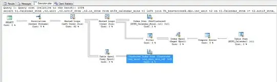

EDIT: As I look at the execution plan, I think I need to filter both tables for the reporting period before conducting the joins. Here's the execution plan:
Execution Plan

    There are only 20160 minutes in 14 days, but you get 26855. Are you sure you apply the correct logic? Can you add the DDL and some example rows? – dnoeth Apr 20 '16 at 17:01
  • @dnoeth, good catch on the row numbers. Each "extra" row above the 20,160 indicates that additional resources were used during that minute. An equally acceptable solution would have had 16,896 rows-the number where there was a value in unit/start_dttm/end_dttm fields and ignoring the 9959 rows where there was a null value (indicative that there were no resources in use during those times). – David0044 Apr 20 '16 at 18:51

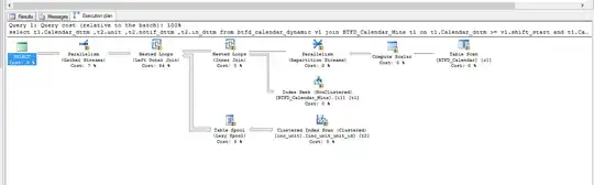

I was able to reduce the query time from 24.5 minutes to 2.5 minutes by making a minor change in the query joins. The modified query makes the initial select statement from my view (14 rows for a biweekly period), and that filters both of the tables down to only the relevant rows.
The new query is:
SELECT t1.calendar_dttm, t2.unit, t2.start_dttm, t2.end_dttm
FROM View_1 v1
JOIN Table_1 t1 on t1.calendar_dttm >= v1.start_dttm AND t1.Calendar_dttm <= v1.end_dttm
LEFT JOIN Table_2 t2 on t1.calendar_dttm >= t2.start_dttm AND t1.calendar_dttm <= t2.end_dttm
WHERE v1.period_diff = -1
And it's Execution Plan:
