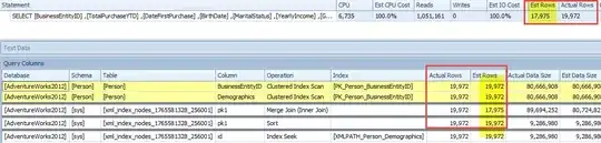

A FAST N will tell SQL Server to generate an execution plan with quickly returning the number of rows defined as N.
Note that the estimates will be as per the N since you are telling sql server to retrieve N rows as fast as possible.
e.g. running below query with fast 500:

Est vs Actual rows with option (fast 500)
Est vs Actual rows without option (fast 500)
