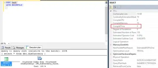

Yes, you can get this information. It is buried inside properties of the select statement in an actual execution plan. To do that:
However, I'm not sure how accurate or what measures this information displays.

I would use method described in this article and compare it with what you see in the properties. If they are equal, then it's milliseconds.
