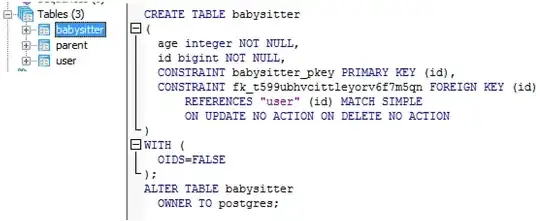

Thanks to @Walter Mitty I am now using the shared-primary-key technique which results in the following design (http://www.tutorialspoint.com/jpa/jpa_advanced_mappings.htm, JPA Joined inheritance):
Don't mind the weird FK name, it is autogenerated.
