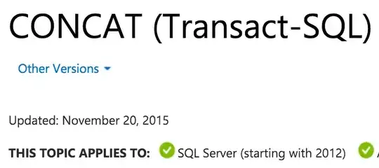

CONCAT was introduced in SQL Server 2012; there is no way to make it work in SQL Server 2008 R2. From the documentation:
There's also no way to make it fail in 2012+, even with compatibility level. So have your people check SELECT @@VERSION; on both servers; you'll find that where CONCAT fails it is < 11. In order to make your code compatible with earlier versions, you'll need to use the standard string concatenation operator (+). I don't know how you would do this with a scalar function, unless you always used the exact same number of input strings and you change your code to use dbo.CONCAT() instead of CONCAT() (there will be scenarios where it matters, plus if your function does anything the native doesn't do, you want consistent behavior if/when you upgrade). So I wouldn't recommend that approach. You may also need to add NULL handling and other minor changes (impossible to tell you how to change your existing script exactly, if we can't see it).
