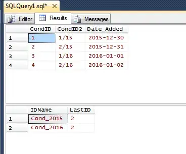

Insert some sample data:
EXEC dbo.InsertCond @DateAdded = '2015-12-30';
EXEC dbo.InsertCond @DateAdded = '2015-12-31';
EXEC dbo.InsertCond @DateAdded = '2016-01-01';
EXEC dbo.InsertCond @DateAdded = '2016-01-02';
Show both tables:
SELECT *
FROM dbo.Cond;
SELECT *
FROM dbo.tblIDs;
Results:
The key table and stored proc come from this question.
