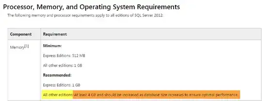

Based on your sp_configure output, you have configured 6GB of max memory. Your installed RAM is ONLY 4GB ! <-- This is the problem
From BOL :
Recommendation :
Based on your workload, you should get more RAM and then set a good value for your MAX MEMORY. As per kb - 918483, you should enable LPM (Lock Pages in Memory).
