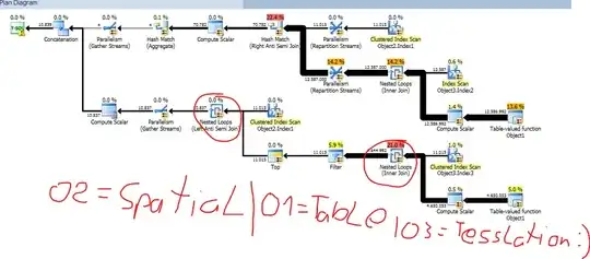

I scripted the table with schema and data, fresh DB, execute. Same error. CHECKDB also has this incredible runtime of 45min. I captured the CHECKDB query plan using SQL Profiler. It has a misguided loop join apparently causing excessive runtime. The plan has quadratic runtime in the number of rows of the table! Doubly nested scanning loop joins.
DBCC execution plan

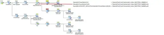

On the 2014 build (with no DBCC errors) the plan looks as follows.

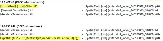

And on the 2016 build (with DBCC errors reported) like this.
The second plan has a single row coming out of the merge anti semi join, the first plan zero rows.
The join predicates are different with respect to what is matched to the pk0 column in the spatial index.
The first one correctly maps it to the table Primary Key, The second maps it to the Id column returned from the TVF.
According to the SQL Server 2012 internals book this is a binary(5) value for the Hilbert number of the cell so this predicate certainly is incorrect (If the Id of the single row in the base table is set to 1052031049 instead of 20171 I no longer see any DBCC errors as this happens to correspond to this value of 0xa03eb4b849).
