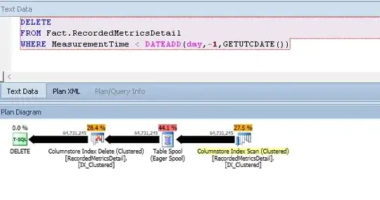

I noticed that there is a large eager spool operator in the execution plan:
This completes with the following characteristics:
  • 60 million rows deleted
  • 1.9 GiB TempDB used
  • 14 minutes execution time
  • Serial plan
  • 1 rebind on spool
  • Estimated cost for scan: 364.821

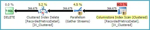

If I trick the estimator into underestimating, I get a faster plan that avoids use of TempDB:
Estimated cost of scan: 56.901
(This is an estimated plan, but the numbers in comments are correct.)

Is there any plausible benefit to the spool iterator in the first plan?
This depends on what you regard as "plausible", but the answer according to the cost model is yes. Of course this is true, because the optimizer always chooses the cheapest plan it finds.
The real question is why the cost model considers the plan with the spool so much cheaper than the plan without. Consider estimated plans created for a fresh table (from your script) before any rows have been added to the delta store:

The standard cost logic is reused for column stores here, so a plan that preserves partition ordering (though not order within each partition) is costed lower. We can see this on the test query by using undocumented trace flag 2332 to require sorted input to the update operator. This sets the DMLRequestSort property to true at the update, and forces the optimizer to produce a plan that provides all rows for one partition before moving to the next:
DELETE Fact.RecordedMetricsDetail
WHERE MeasurementTime < DATEADD(day,-1,GETUTCDATE())
OPTION (RECOMPILE, QUERYTRACEON 2332);
The estimated cost for this plan is very much lower, at 52.5174 units:
DMLRequestSort=true plan
This reduction in cost is all due to the lower estimated I/O cost at the update. The introduced Spool performs no useful function, except it can guarantee output in partition order, as required by the update with DMLRequestSort = true (the serial scan of a column store index cannot provide this guarantee). The cost of the spool itself is considered to be relatively low, especially compared with the (probably unrealistic) reduction in cost at the update.
The decision about whether to require ordered input to the update operator is made very early on in query optimization. The heuristics used in this decision have never been documented, but can be determined through trial and error. It seems that the size of any delta stores is an input to this decision. Once made, the choice is permanent for the query compilation. No USE PLANhint will succeed: the target of the plan either has ordered input to the update, or it does not.
