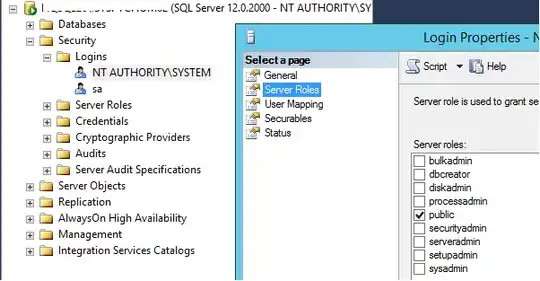

In this Link by mssqltips there is a tool called PsExec. Following the tutorial I could run the program and connect to SQL Server with NT AUTHORITY\SYSTEM. But it's not working. NT AUTHORITY\SYSTEM is Public and I can't add my account with sysadmin. Does this program runs only with SQL 2008?

I can connect with the NT AUTHORITY\SYSTEM user but when I try to create a sysadmin login or change sa password, it says I have no rights to do that. And then, looking at the nt rights, it's public. I could change the sa login with the -m trick on my machine, but I would like something that does not require to shutdown the SQL.

As far as I am aware, there is not way to do this without some downtime for the SQL Server. If there are no known sysadmin users on the server, you will have to take it down for at least a few minutes.
(I believe that the psexec method mentioned in the question body worked on older versions of SQL Server, but as the OP discovered, at least as of SQL Server 2014, even NT AUTHORITY\SYSTEM is not a sysadmin.)
If the -m method you mention in the body - which does require restarting SQL server - will work for you, the technet article linked by @Aaron may be exactly what you need. However, you will run into trouble if Mixed Mode Authentication is not enabled - if it isn't, SQL Sever will refuse to authenticate the SQL login you just created.
