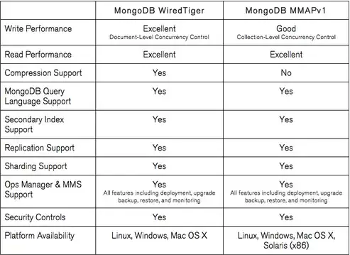

I found a comparing table on MongoDB's blog:
WiredTiger and MMAPv1 comparison
So except if you are on Solaris, is there a reason not to choose WiredTiger?
