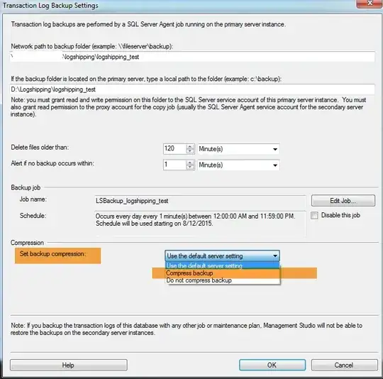

I think log shipping is probably a good approach but I'm concerned I won't be able to compress the tlogs
Since you are using logshipping on SQL Server 2012, you can compress your transaction log backups
(they'll be big).
Take frequent log backup, so that the size of the T-logs is manageable and you are using backup compression (see above screenshot). The minimum is 1 min.

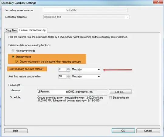

My question is, can I manually set up log-shipping, essentially leaving the primary untouched and just restore 24 hours worth of transactions on the secondary each day - whilst still being able to read from the secondary during the day?
Yes you can do what you are saying. You can delay the restoration of log backups on the secondary server. So, just have to copy job to copy the log backups from primary to secondary and depending on your need and business requirement, you can delay the log restoration.
Note that when T-logs are being restored, users will be disconnected.
