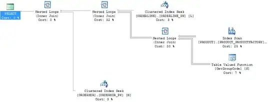

I have a problem understanding why SQL server decides to call user defined function for every value in the table even though only one row should be fetched. The actual SQL is a lot more complex, but I was able to reduce the problem down to this:
select
    S.GROUPCODE,
    H.ORDERCATEGORY
from
    ORDERLINE L
    join ORDERHDR H on H.ORDERID = L.ORDERID
    join PRODUCT P  on P.PRODUCT = L.PRODUCT
    cross apply dbo.GetGroupCode (P.FACTORY) S
where
    L.ORDERNUMBER = 'XXX/YYY-123456' and
    L.RMPHASE = '0' and
    L.ORDERLINE = '01'

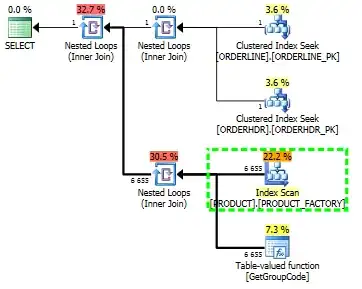

For this query, SQL Server decides to call GetGroupCode function for every single value that exists in PRODUCT Table, even though the estimate and actual number of rows returned from ORDERLINE is 1 (it's the primary key):
Query Plan
Same plan in plan explorer showing the row counts:
Plan explorer Tables:
ORDERLINE: 1.5M rows, primary key: ORDERNUMBER + ORDERLINE + RMPHASE (clustered)
ORDERHDR:  900k rows, primary key: ORDERID (clustered)
PRODUCT:   6655 rows, primary key: PRODUCT (clustered)
The index being used for the scan is:
create unique nonclustered index PRODUCT_FACTORY on PRODUCT (PRODUCT, FACTORY)

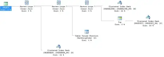

I was able to "fix" the performance by forcing SQL server to fetch the top 1 product, although 1 is max that can ever be found:
select
    S.GROUPCODE,
    H.ORDERCAT
from
    ORDERLINE L
    join ORDERHDR H
        on H.ORDERID = M.ORDERID
    cross apply (select top 1 P.FACTORY from PRODUCT P where P.PRODUCT = L.PRODUCT) P
where
    L.RMPHASE = '0' and
    L.ORDERLINE = '01'
Then the plan shape also changes to be something I expected it to be originally:
Query Plan with top

There are three main technical reasons you get the plan you do:
  1. The optimizer's costing framework has no real support for non-inline functions. It does not make any attempt to look inside the function definition to see how expensive it might be, it just assigns a very small fixed cost, and estimates the function will produce 1 row of output each time it is called. Both these modelling assumptions are very often completely unsafe. The situation is very slightly improved in 2014 with the new cardinality estimator enabled since the fixed 1-row guess is replaced with a fixed 100-row guess. There is still no support for costing the content of non-inline functions, however.
  2. SQL Server initially collapses joins and applies into a single internal n-ary logical join. This helps the optimizer reason about join orders later on. Expanding the single n-ary join into candidate join orders comes later, and is largely based on heuristics. For example, inner joins come before outer joins, small tables and selective joins before large tables and less selective joins, and so on.
  3. When SQL Server performs cost-based optimization, it splits the effort into optional phases to minimize the chances of spending too long optimizing low-cost queries. There are three main phases, search 0, search 1, and search 2. Each phase has entry conditions, and later phases enable more optimizer explorations than earlier ones. Your query happens to qualify for the least-capable search phase, phase 0. A low enough cost plan is found there that later stages are not entered.
Given the small cardinality estimate assigned to the UDF apply, the n-ary join expansion heuristics unfortunately reposition it earlier in the tree than you would wish.
The query also qualifies for search 0 optimization by virtue of having at least three joins (including applies). The final physical plan you get, with the odd-looking scan, is based on that heuristically-deduced join order. It is costed low enough that the optimizer considers the plan "good enough". The low cost estimation and cardinality for the UDF contributes to this early finish.
Search 0 (also known as the Transaction Processing phase) targets low-cardinality OLTP-type queries, with final plans that usually feature nested loops joins. More importantly, search 0 runs only a relatively small subset of the optimizer's exploration abilities. This subset does not include pulling an apply up the query tree over a join (rule PullApplyOverJoin). This is exactly what is required in the test case to reposition the UDF apply above the joins, to appear last in the sequence of operations (as it were).

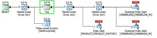

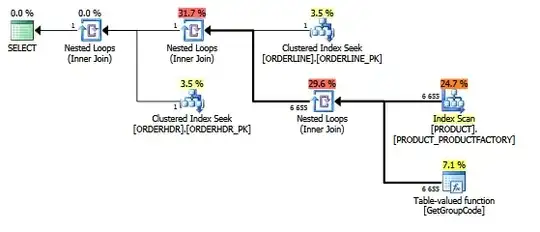

It looks like this is a cost based decision by the optimizer but a rather bad one.
If you add 50000 rows to PRODUCT the optimizer thinks the scan is too much work and gives you a plan with three seeks and one call to the UDF.
The plan I get for 6655 rows in PRODUCT
With 50000 rows in PRODUCT I get this plan instead.
I guess the cost for calling the UDF is grossly underestimated.

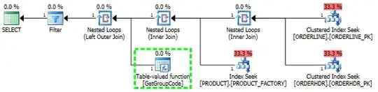

One workaround that works fine in this case is to change the query to use outer apply against the UDF. I get the good plan no matter how many rows there are in the table PRODUCT.
select
    S.GROUPCODE,
    H.ORDERCATEGORY
from
    ORDERLINE L
    outer apply dbo.GetGroupCode (P.FACTORY) S
where
    L.RMPHASE = '0' and
    L.ORDERLINE = '01' and
    S.GROUPCODE is not null
