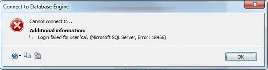

I'm trying to change the password of the sa account using SQL Server Management Studio 2012. I've followed the steps below but the password is still the same.
  1. Login into the SQL Server Management Studio, Select Database Engine, \SBSmonitoring, Windows Authentication.
  2. Go to Object Explorer--Security folder--Logins folder.
  3. Right click on SA account and select the Properties option.
  4. In General Page, change the SA password and confirm it.
  5. In Status Page, change Login to Enabled. Click OK to save the change.
  6. Restart the SQL Server and all its services.
Any idea ?

    Verify your instance is set to Mixed Authentication. –  Jun 11 '15 at 15:42
    The ERRORLOG will tell you the reason for logon failure. If mixed authentication is not enabled, you will see "Login failed for user 'sa'. Reason: An attempt to login using SQL authentication failed. Server is configured for Windows authentication only." Moreover, why on earth are you using sa? It's a well know login and a potential attack vehicle: disable it and configure a different sysadmin login. – spaghettidba Jun 11 '15 at 15:51
    What error are you getting when you try to log in? Has the server been configured for Windows Authentication only? Is the sa account disabled? Has the sa account been renamed and another account named sa been added? What do you get when you run these: SELECT CASE SERVERPROPERTY('IsIntegratedSecurityOnly') WHEN 1 THEN 'Windows Authentication' WHEN 0 THEN 'Windows and SQL Server Authentication' END as [Authentication Mode]; SELECT name, type_desc, is_disabled FROM sys.server_principals WHERE sid = 0x01; SELECT * FROM sys.syslogins WHERE sid = 0x01; – Bacon Bits Jun 11 '15 at 15:27

You were really near with your solution. You just have to restart the SQL Server instance \SBSMonitoring after changing the sa password as explained in the following article and ensure that Mixed Mode Authentication is turned on.
Solution
Reference: What is the default password for 'sa' account in windows sbs 2011 standard (I have modified the orginal listing slightly):
    • Select Database Engine, <SBSservername>\SBSmonitoring
    • open Server Properties
    • click on the Security section
    • select SQL Server and Windows Authentication mode
    • Click on OK
    • Restart SQL Server instance
This should do the job.
Alternative solution
Run the following statement to set the SQL Server instance to Mixed mode:
USE [master]
GO
EXEC xp_instance_regwrite N'HKEY_LOCAL_MACHINE', N'Software\Microsoft\MSSQLServer\MSSQLServer', N'LoginMode', REG_DWORD, 2
GO
Then restart your server and change the sa password as you normally would.
Mixed Mode (SQL Server and Windows Authentication mode)
If you don't turn on Mixed Mode authentication you will constantly receive an error message when trying to log in with the sa SQL Server login even though you have changed the password and enabled the login.
Login error Windows Authentication mode
Enabling Mixed Mode (aka, SQL Server and Windows Authentication mode) will get rid of this error message.
