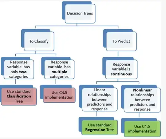

I would add that decision trees can be used for both classification and regression tasks. DT on the other hand predicts a class in the accepted answer would be more specific by describing Classification trees which is technically a subtype of the generic DT concept. One reference(ignoring the bottom layers that discuss specific implementations):
types of decision trees
From here
