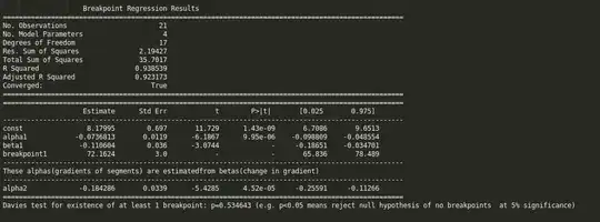

The piecewise-regression Python library does exactly this.
import piecewise_regression
import matplotlib.pyplot as plt
x = [45, 47, 49, 51, 53, 55, 57, 59, 61, 63, 65, 67, 69, 71, 73, 75, 77, 79, 81, 83, 85]
y = [5.31, 4.5, 4.4, 4.1, 4.55, 3.47, 4.55, 3.67, 3.86, 3.56, 3.94, 2.75, 3.14, 2.89, 3.01, 2.01, 1.95, 1.4, 1.35, 1.17, 0.33]
pw_fit = piecewise_regression.Fit(x, y, n_breakpoints=1)
pw_fit.plot()
plt.show()
And it gives you a statistical summary:
pw_fit.summary()
It uses the same method as the segmented R package.
