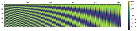

This is my understanding, feel free to correct me, I feel looking at how n visually impact the positional encoding matrix helpful.
Here is the same positional encoding (sequence length=100 and dimension=512) but with different values of n
for = 10000 enter image description here
for n = 100 enter image description here
for n = 20 enter image description here
and for n = 1 enter image description here
If you think about the purpose of positional encoding: providing a unique vector representation encoding the position of each token, it means each row represent a position and the further apart two positions the greater the distance between this vector.
Now, look what happens when you compute the cosine distance between the first vector and each remaining one:
orange: n = 10000 blue: n = 20 green: n = 1
With large n the distance is a monotonically increasing function of the position (in term of index in the sequence) which make sense since we're talking about position of token. But it's not the case with smaller value of n.
Now I don't know if there's any rule regarding how to set an appropriate n depending on the other parameters.

I offer a slightly different perspective. Your typical sentence is 15-20 words long. Their shortest wavelength is ~6. Their longest wavelength is ~60000. As you can see from Yoan's first fig, for sentences up to length 20, the positional encoding for about half the channels (i>256) are basically constant because the wavelength is so long. Thus half the channels get no positional information, which may actually be good for some information. After all, adding (as opposed to concatenating) the positional encoding is a little strange in that it could corrupt useful information in the input.
