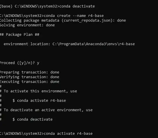

You need to create a new environment and then you can install R 4.+ in Anaconda. Follow these steps.
conda create --name r4-base
After activating r4-base run these commands
conda activate r4-base
conda install -c conda-forge r-base
conda install -c conda-forge/label/gcc7 r-base
Finally, you will notice r-basa version 4 will be installed.
