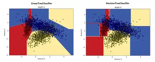

You are looking for Linear Trees.
Linear Trees differ from Decision Trees because they compute linear approximation (instead of constant ones) fitting simple Linear Models in the leaves.
For a project of mine, I developed linear-tree: a python library to build Model Trees with Linear Models at the leaves.
linear-tree is developed to be fully integrable with scikit-learn.
from sklearn.linear_model import *
from lineartree import LinearTreeRegressor, LinearTreeClassifier
REGRESSION
regr = LinearTreeRegressor(base_estimator=LinearRegression()) regr.fit(X, y)
CLASSIFICATION
clf = LinearTreeClassifier(base_estimator=RidgeClassifier()) clf.fit(X, y)
LinearTreeRegressor and LinearTreeClassifier are provided as scikit-learn BaseEstimator. They are wrappers that build a decision tree on the data fitting a linear estimator from sklearn.linear_model. All the models available in sklearn.linear_model can be used as linear estimators.
Compare Decision Tree with Linear Tree:
  • does this work on big big data/tree ? e.g. 1M leafs ? each leaf 80 feature ? – user702846 May 20 '21 at 12:47
  • it can reach a max_depth of 20, but consider that linear trees usually converge faster than decision trees, i.e. less deep structures... the more you want to go deep or be precise in the splits, the higher the training time – Marco Cerliani May 20 '21 at 12:56
