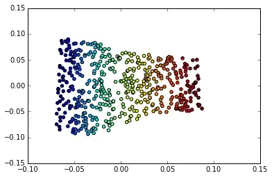

There are many techniques to "unwrap" these manifolds. One of them is called Locally Linear Embedding, and this is how it would do that:
Here's a scikit-learn snippet for doing that:
from sklearn.manifold import LocallyLinearEmbedding
lle = LocallyLinearEmbedding(n_neighbors=k, n_components=2)
X_lle = lle.fit_transform(data)
plt.scatter(X_lle[:, 0], X_lle[:, 1], c=color)
plt.show()
