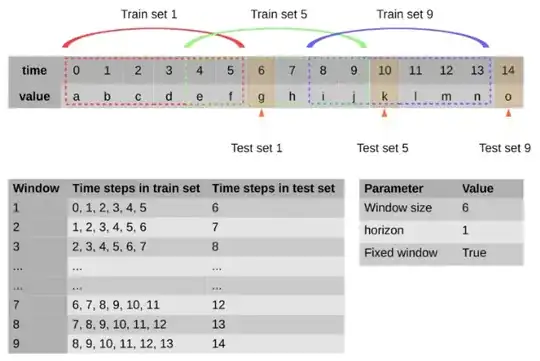

If so, it would perhaps make sense (at least for your test accuracy) to always validate against the time-step that immediately follows a test batch. This is what you would actually want to be doing with the model once it is trained.
Have a look at this answer, where I explain the idea in a lot more detail. The main idea is to split data into a kind of rolling forecast pattern, whereby you would have a test batch e.g. with something like:

That is just pseudo code to make it as clear as possible. Here is the diagram I created for the post linked above, which visualises the same notion:
rolling window validation
In the image, it just has train/test sets... you could of course add validation into the mix.

  • But here you are using the same data for both training and testing. It's a fundamental error to mix training and testing data. Maybe I've misunderstood your answer because it doesn't seem right? – Stand with Gaza May 21 '20 at 00:29
