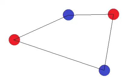

And that's why the VC dimension of $H$ is 3. Because for any 4 points in 2D plane, a linear classifier can not shatter all the combinations of the points. For example,
For this set of points, there is no separating hyper plane can be drawn to classify this set. So the VC dimension is 3.

  • So one set of points means any one of the possible arrangements of the points right? In my question, the figure with 8 subplots represents one set of points and the linear arrangement of the points is another set right? And so if one set (any one) is completely classified, it is called shattered. And there is no set of four points which can completely classified by the linear classifier (i.e. shattered by linear classifier) and that's why the VC dimension of linear classifier is 3. This is what I understood till now. Correct me if I'm wrong at any point. – Kaushal28 Jun 03 '18 at 18:57
    Figure with 8 subplots is a very good illustration of what is shattering. Here you have 3 points, 2 classes, so 2^3=8 possible labelings of these 3 points. All 8 labelings can be done and isolated with a line therefore this set can be shattered by a line. The figure with 4 points: it has some labelings that can be isolated with a line (say, two left are red, two right are blue) but also has a labeling that cannot be isolated with a line (like in the Figure: upper and lower blue; left and right are left). As it has a labeling that cannot be isolated with a line, this set is not shattered. – Vladislav Gladkikh Jun 04 '18 at 01:33
