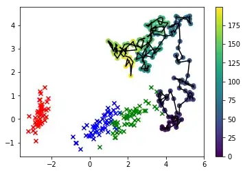

To demonstrate, I'm going to leverage some convenience code you can find here, which provides the GenerativeSampler class which wraps code from my original response, some additional code for this better solution, and some additional features I was playing around with (some which work, some which don't) which I probably won't get into here.
np.random.seed(123)
sampler = GenerativeSampler(model=RFC, X=X, y=y,
                            target_class=2,
                            prior=None,
                            class_err_prob=0.05, # <-- the score we use for candidates that aren't predicted as the target class
                            rw_std=.05,          # <-- controls the step size of the random walk proposal
                            verbose=True,
                            use_empirical=False)
samples, _ = sampler.run_chain(n=5000)
burn = 1000
thin = 20
X_s = pca.transform(samples[burn::thin,:])
# Plot the iris data
col=['r','b','g']
for i in range(3):
    plt.scatter(*X_r[y==i,:].T, c=col[i], marker='x')
plt.plot(*X_s.T, 'k')
plt.scatter(*X_s.T, c=np.arange(X_s.shape[0]))
plt.colorbar()
plt.show()
In this visualization, the x's are the real data, and the class we're interested in is green. The line-connected dots are the samples we drew, and their color corresponds to the order in which they were sampled, with their "thinned" sequence position given by the color bar label on the right.
As you can see, the sampler diverged from the data fairly quickly and then just basically hangs out pretty far away from values of the feature space that correspond to any real observations. Clearly this is a problem.

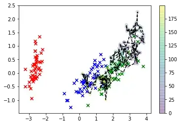

burn = 1000
thin = 20
col=['r','b','g']
for i in range(3):
plt.plot(*X_s.T, 'k--')
plt.scatter(*X_s.T, c=np.arange(X_s.shape[0]), alpha=0.2)
plt.colorbar()
plt.show()
Much better! Now, we can estimate your "optimal" $X$ value using what's called the "maximum a posteriori" estimate, which is a fancy way of saying we fit a second KDE -- but to our samples this time -- and find the value that maximizes the KDE, i.e. the value corresponding to the mode of $P(X|Y)$.
