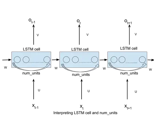

On this blog link, I found this scheme of a LSTM architecture
LSTM

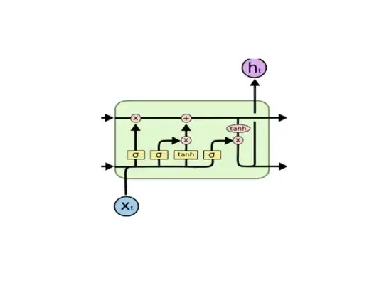

Where apparently, every circle should correspond to an individual LSTM unit like this

  1. Is this correct?
Yes the diagrams both look correct to me. The key thing to understanding both diagrams is that the inputs and outputs of an LSTM cell are vectors.
The circles in the first diagram do represent the concept that the layer contains multiple individual artificial neurons, and that might make you assume that the second diagram is a picture of one of those neurons. Arguably there are multiple "neurons" or sub-layers with different roles inside a cell, because there are multiple places in which calculations of the form $f(W\mathbf{x} +b)$ occur, performing slightly different roles. I think the term "cell" is used to refer to this architecture of neurons. As a short-hand when I say "neuron", I tend to think of the output stage of the hidden layer.
However, in the second diagram, all of the operations shown work with vectors. Most importantly the left-to-right arrows in the second diagram represent vectors of hidden state from timestep to timestep from the whole layer. So each neuron in the cell is recurrently connected to every other neuron in that cell - twice as it happens in an LSTM, because LSTMs have both an internal cell state and a layer output.

  1. Imagine I have the following configuration: Number of samples = 1000 Number of time-steps = 10 Number of features = 5 In this case, each unit in a cell will take as input a vector of size 5 right?
Almost. Each neuron inside the cell will take an input of 5 from $\mathbf{x}$, plus an input of the hidden layer output, $\mathbf{h}$. So if in your case the LSTM cell size was 10, then each neuron would take a combined vector of 15. In addition, a second cell state vector is maintained, not labelled in your diagram. That is not used directly as an input to any neurons (i.e. components of the form $f(W\mathbf{x}+b)$), but does interact with the other values and can get changed itself, through the various gates. In your second diagram, it is the uppermost arrow going left to right.

The cell as a whole will have the output of whatever size you have made the layer. That is what the diagram number 2 tries to show. However, using our working definition of "unit", the output of each unit will be two scalar values - the hidden layer output, and the cell state - which will be part of their respective vectors shown in the diagrams.

  • thank you for the answer, but it seems that first OP's question should be answered "No". $unit$ seems to be analog of feed-forward $node$, or $neuron$. So second picture looks like a "cell" which, as you correctly admit, corresponds to $layer$ concept (there is the same discussion in comments of OP's link post). – garej Jun 21 '20 at 19:47
I think your image is mislabeled. I think each blue box is an LSTM layer, composed of multiple cells/units, each of which accepts a vector input x_t.
With that, the answers to your questions are:
1) Yes
2) Yes, they are independent (at a single time step - they share information with each other between time steps)
3) Yes, each unit cell will take an input of size 5. I think the output size is always 1, similar to neural network nodes (like sigmoidal units) that combine and then activate.

  • I confirm that the output size is always one, because each LSTM unit esentially works similar to ordinary neuron. It's up to the following layer to distribute this single value to its multiple neurons – Kari Mar 07 '18 at 21:31
    An "LSTM layer" is also called an "LSTM cell" AFAIK. When you add an LSTM cell in most frameworks you get to specify the layer size. So the labelling does appear to follow that convention. – Neil Slater Mar 08 '18 at 08:01
