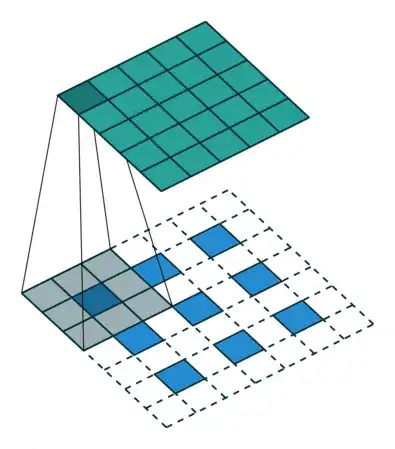

Alternatively, we can additionally insert padding in between the input data, and sweep the kernel over it without as much padding. Clearly we will sometimes be concerning ourselves with the exact same input points more than once for a single kernel; this is where the term "fractionally-strided" seems more well-reasoned. I think the following animation (borrowed from here and based (I believe) off of this work will help to clear things up despite being of different dimensions. The input is blue, the white injected zeros and padding, and the output green:
transposed conv, input is blue, output green
Of course, we're concerning ourselves with all of the input data as opposed to dilation which may or may not ignore some regions entirely. And since we're clearly winding up with more data than we began, "upsampling".

Though both seem to be doing the same thing, which is up-sampling a layer, there's a clear margin between them.
