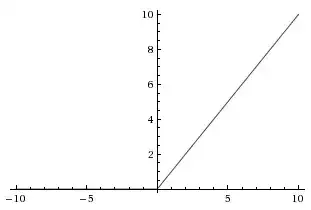

       <b>Left:</b> Rectified Linear
Unit (ReLU) activation function, which is zero when x < 0 and then linear with slope 1 when x > 0. Right: A plot from Krizhevsky et al. (pdf) paper indicating the 6x improvement in convergence with the ReLU unit compared to the tanh unit.
ReLU. The Rectified Linear Unit has become very popular in the last few years. It computes the function $f(x) = \max(0, x)$. In other words, the activation is simply thresholded at zero (see image above on the left). There are several pros and cons to using the ReLUs:
  • (+) It was found to greatly accelerate (e.g. a factor of 6 in Krizhevsky et al.) the convergence of stochastic gradient descent compared to the sigmoid/tanh functions. It is argued that this is due to its linear, non-saturating form.
