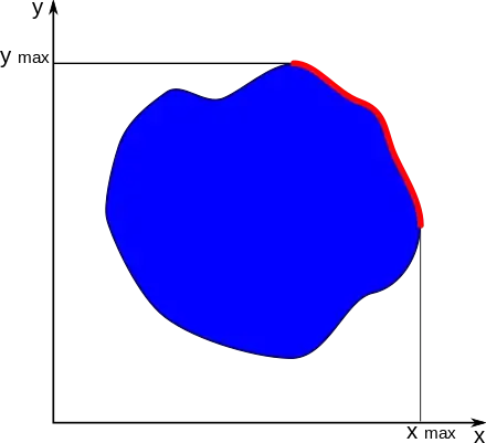

Point 2 can be expanded to other classification settings: in a typical data science project you might find a multi-class classification setting where simple 1 dimensional threshold tuning will not work anymore to improve the precision/recall tradeoff for all classes equally. (And you might have to make this tradeoff due to a high cost imbalance)
How can you solve these multi target optimizations from point 2? You could use oversampling/downsampling/weighting as an indirect way to find different Pareto optimal points. Given different fractions of targets in up- or downsampling you will achieve different values of precision and recall and will move on the Pareto front.red Pareto front (bigger is better) with x axis e.g. recall and y axis precision. Since there is no total order (but only the Pareto order https://en.m.wikipedia.org/w/index.php?title=Pareto_order) you cannot decide which point on the Pareto front is better, image by Berklas under CC-by SA (red Pareto front (bigger is better) with x axis e.g. recall and y axis precision. Since there is no total order (but only the Pareto order https://en.m.wikipedia.org/w/index.php?title=Pareto_order) you cannot decide which point on the Pareto front is better, image by Berklas under CC-by SA)
Ways to find a Pareto optimal solution while avoiding to fudge with the class frequencies by upsampling or downsampling:

Summary:
When solving a multi-objective optimization problem 2), rather than doing oversampling/undersampling with unknown a-priori outcome, you might better do:
  • Cost-sensitive learning
  • Regularization (for the bias-variance tradeoff)
  • Threshold-tuning
in order to achieve your pareto-optimal solution in more direct way.
