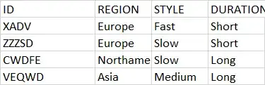

  • One-to-One dataset: One ID has One attribute/feature per column - Describes a financial product
  • One-to-Many: One ID has multiple attributes/features per column - What a financial product consists of and the corresponding weights within the financial product
the One-to-One dataset looks like:
ID         REGION           STYLE         DURATION
