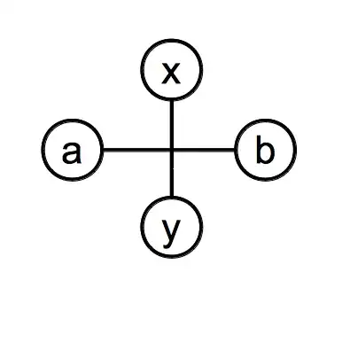

No. At least, no "nice" gadget for one crossover.
Let $(a, b)$ and $(x,y)$ be a cross we want to replace.enter image description here
There are many cases for our graph, $G$, but we have to satisfy at least the following four. Case 1: there is at least one hamiltonian cycle, but none use either of the edges. Case 2: there is at least one cycle, and all cycles use exactly one of the two edges. Case 3: there is at least one cycle, and all cycles use both edges. Case 4: there is no hamiltonian cycle.

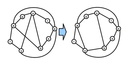

However, that replacement breaks the fourth case, because $G'$ could contain a hamiltonian cycle when $G$ does not. Take, for example, $G = (V, E)$ where $V = \{a, b, x, y, p, q, r, s, t\},$ and $E = \{(a, b), (x, y), (a, r), (a, p), (a, q), (b, s), (b, x), (p, s), (p, t), (p, y), (q, x), (r, y), (t, x)\}$. $G$ is not planar and does not have a hamiltonian cycle.enter image description here
Then $G' = (V, E')$ where $E' = \{(a, y), (y, b), (x, b)\} \cup$ $\{(x, y), (a, r), (a, p), (a, q), (b, s), (p, s), (p, t), (p, y), (q, x), (r, y), (t, x)\}$. $G'$ is planar, and has a hamiltonian cycle ($a, q, x, t, p, s, b, y, r, a$).
Note that if $(b, y)$ was the edge not added instead of $(a, x)$, then $G'$ would not have a hamiltonian cycle. It seems that you'd have to have knowledge of the possible cycle to choose the edge correctly, though.
