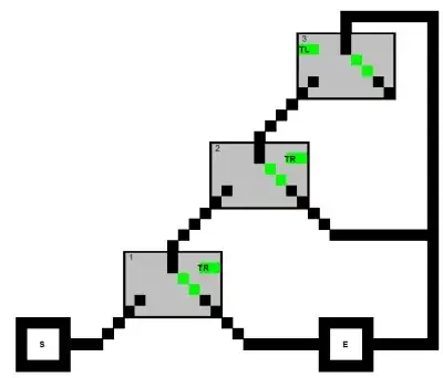

This is a quick draw of a trivial network (made with Excel ... I'll make a better one):
example2
A trivial solutions is:
S -> 1 -> 2 -> 3 -> 2 -> E -> 1 -> E

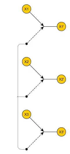

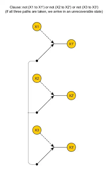

In the following illustrations, switches are drawn as two incoming arrows, one of which is dashed (disabled). The target direction is drawn with a black circle (such that the solid arrow must eventually be on the side of the circle).
Remark: We will use boldface to distinguish the Exit of the graph from exits of gadgets.
For the One-way gadget, entrance $A$ cannot be reached from exit $B$ until $B$ has been reached from $A$. For the Clause gadget, entrances $X1$, $X2$ and $X3$ lead to exits $X1'$, $X2'$ and $X3'$, respectively.
One-way gadget Clause gadget

So consider the second case where the path traverses all three switches of some Clause gadget. Then that gadget will have all its three switches flipped (see below). This is where we make use of the target positions. Notice that the gray backbone of the Clause gadget can no longer be reached, meaning that the switches can no longer be directed to their target positions. In this case, we say that this Clause gadget is unrecoverable.
Deadlocked Clause
