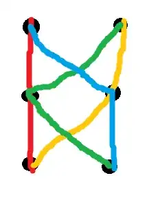

This condition is sometimes called "consistency" (a set of paths is consistent if the intersection of any two is a subpath of each). It follows from the above that consistency is not sufficient. One of the two tied-for-smallest counterexamples is the following color-coded system of four paths over six nodes:
In other words, there is no way to assign weights to the 8 edges pictured here so that all of these four paths are simultaneously the unique shortest path between their endpoints. However, any pair of them intersect on just one node, so they are consistent (even if we fill them out with a few additional paths in the right way to have $n \choose 2$ in total). There are infinitely many counterexamples like this one; see the paper for a characterization.
