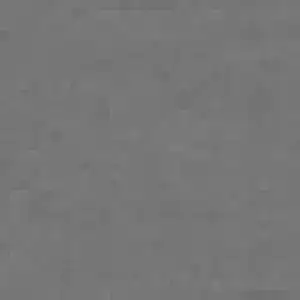

I did a very simple experiment:
  • I took a grey card. To a human eye, it looks like a plain, neutral piece of grey cardboard. In particular, there is no information.
  • And then I took a normal scanner – exactly the kind of device that people might use to digitise their photos.
  • I scanned the grey card. (Actually, I scanned the grey card together with a postcard. The postcard was there for sanity-checking so that I could make sure the scanner software does not do anything strange, such as automatically add contrast when it sees the featureless grey card.)
  • I cropped a 1000x1000 pixel part of the grey card, and converted it to greyscale (8 bits per pixel).
What we have now should be a fairly good example of what happens when you study a featureless part of a scanned black & white photo, for example, clear sky. In principle, there should be exactly nothing to see.
However, with a larger magnification, it actually looks like this:
30x30 crop, magnified by factor 10

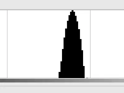

There is no clearly visible pattern, but it does not have a uniform grey colour. Part of it is most likely caused by the imperfections of the grey card, but I would assume that most of it is simply noise produced by the scanner (thermal noise in the sensor cell, amplifier, A/D converter, etc.). Looks pretty much like Gaussian noise; here is the histogram (in logarithmic scale):
histogram
Now if we assume that each pixel has its shade picked i.i.d. from this distribution, how much entropy do we have? My Python script told me that we have as much as 3.3 bits of entropy per pixel. And that's a lot of noise.
If this really was the case, it would imply that no matter which compression algorithm we use, the 1000x1000 pixel bitmap would be compressed, in the best case, into a 412500-byte file. And what happens in practice: I got a 432018-byte PNG file, pretty close.

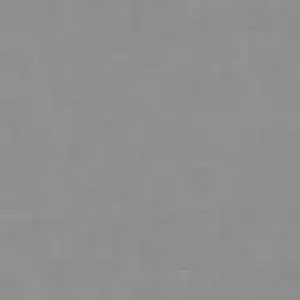

Another example, with an attempt to find over-idealised conditions:
  • A modern DSLR camera, using the lowest sensitivity setting (least noise).
  • An out-of-focus shot of a grey card (even if there was some visible information in the grey card, it would be blurred away).
  • Conversion of the RAW file into a 8-bit greyscale image, without adding any contrast. I used typical settings in a commercial RAW converter. The converter tries to reduce noise by default. Moreover, we are saving the end result as an 8-bit file – we are, in essence, throwing away the lowest-order bits of the raw sensor readings!

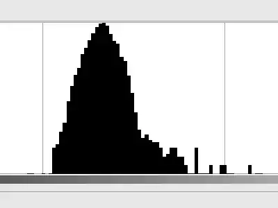

And what was the end result? It looks much better than what I got from the scanner; the noise is less pronounced, and there is exactly nothing to be seen. Nevertheless, the Gaussian noise is there:
30x30 crop, magnified by factor 10 histogram
And the entropy? 2.7 bits per pixel. File size in practice? 344923 bytes for 1M pixels. In a truly best-case scenario, with some cheating, we pushed the compression ratio to 1:3.

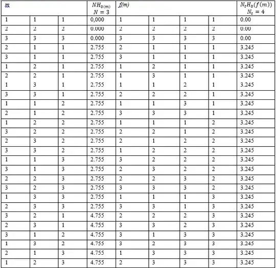

Now, we prove the obtained result experimentally. Let's take a sequence of length 3 and alphabet 3, the possible sequences are 27. If we increase the length to 4 and keep the alphabet at 3, the possible sequences become 81. Of these 81, we select the 27 with the smallest value of H0(m). In this way, the two sets have the same number of elements. Thus, we can define a one-to-one relationship between the sequences of the two sets. The following table shows the 27 elements of the two sets. In the first column, we have message m, in the second column, we have NH0(m), in the third column, we have the transformed message f(m) and in the fourth column, we have NtH0(f(m)) of the transformed message f(m).
The average value of zero order empirical entropy multiplied by the string length N=3 of the messages m is: Avg(NH0(m))=2.893 with N=3. The average value of zero order empirical entropy multiplied by the length of the string Nt=4 of the transformed messages f(m) is: Avg(NtH0(f(m))=2.884 con Nt=4 Thus, you can see that although the transformed messages are longer, the average value of zero-order empirical entropy multiplied by the message length is, on average, smaller when the transform is applied. Consequently, even if we do not know the source, we know that by applying the transform, we obtain, on average, a reduction in the value of zero-order empirical entropy multiplied by the length of the message. Therefore, the length of the encoded message (symbols replaced by codewords) decreases.
Now, let's look at the encoding scheme, in this case making an evaluation is more difficult because the length of the encoding scheme depends on the compression method used. But, we know that, from a theoretical point of view, the parameter that most influences the length of the encoding scheme is the size of the alphabet. Therefore, we calculate the average size of the alphabet A in the two sets. The mean value of the alphabet size |A|, in the case of messages in the first column of the table, is: Avg(|A|)=2.1 The mean value of the alphabet size |A|, in the case of transformed messages f(m) in the third column of the table, is: Avg(|A|)=1.89 The result obtained is not valid only for the reported case. Indeed, whatever the size of the alphabet, the transformed set being composed of longer sequences always has a greater number of type classes with a number of symbols less than |A|. With type class, we mean a set of strings that all have the same symbol frequency, for example, string 113 and string 131 belong to the same type class in fact, both have symbol frequency 1=2/3 and 3=1/ 4.
Therefore, being on average NH0(f(m))<NH0(m) and coding scheme f(m) < coding scheme m, we have experimentally demonstrated the following inequality:
NH(X)< Avg(NH0(f(m)+ coding scheme)< Avg(NtH0(m)+coding scheme)
In this way, the set of transformed messages has an average compressed message length, using entropy encoding, less than the set of untransformed messages. Consequently, when the source is not known, if the described transform is applied, a reduction of the compressed message is obtained on average. Therefore, we are able to reduce the inefficiency caused by not knowing the source.
