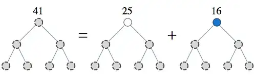

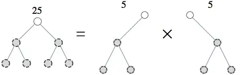

Suppose you want to count the number of independent sets in the following graph.
Independent sets can be partitioned into ones where top node is occupied, and ones where it is unoccupied
Now, notice that knowing whether top node is occupied, you can count number of independent sets in each subproblem separately, and multiply them. Repeating this process recursively gives you an algorithm to count independent sets based on graph separators.

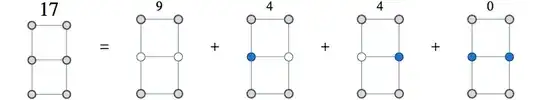

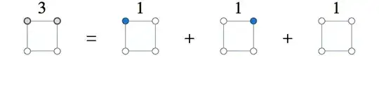

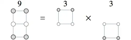

Now, suppose you no longer have a tree. This means separators are bigger, but you can use the same idea. Consider counting independent sets in the following graph.
Use the same idea of breaking the problem into subproblems on the separator you get the following
Like in the previous example, each term in the sum decomposes into two smaller counting tasks across the separator.
Note that we have more terms in the sum than in the previous example because we have to enumerate over all configurations on our separator, which can potentially grow exponentially with size of the separator (size 2 in this case).

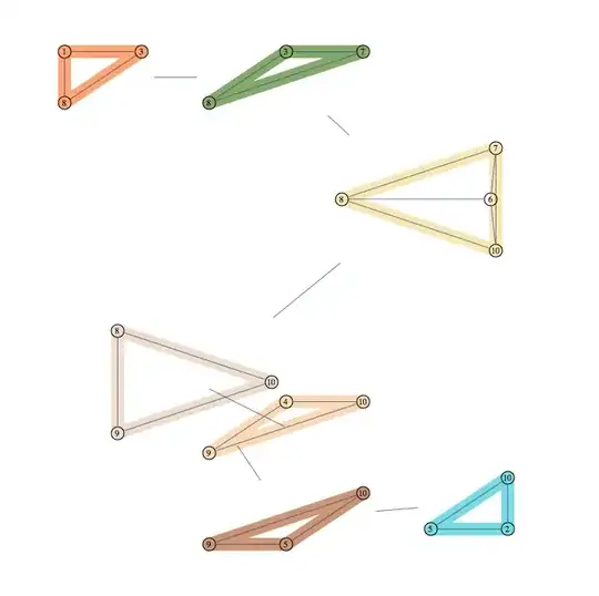

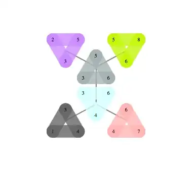

Tree decomposition is a data-structure to compactly store these recursive partitioning steps. Consider the following graph and its tree decomposition
To count using this decomposition you'd first fix values in nodes 3,6 which breaks it into 2 subproblems. In the first subproblem you'd additionally fix node 5, which breaks its part into two smaller subparts.
Size of the largest separator in an optimal recursive decomposition is precisely the tree width. For larger counting problems, size of the largest separator dominates the runtime, which is why this quantity is so important.

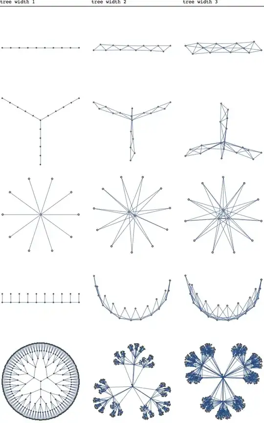

Here are some chordal graphs and their tree-width.
