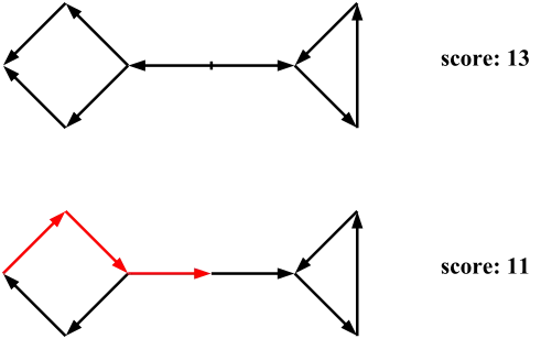

The greedy algorithm is not optimal: The algorithm "fix some orientation then repeatedly flip the orientation of an edge that decrease the score" is not optimal. The following is a counter example found by alt-tab.
