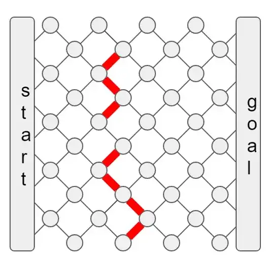

  3. I initially thought that the Bellman-Ford algorithm would work, after tweaking it so that each node refused to backtrack to its current predecessor. However, this can create deadlock situations where the optimal solution is to detour through multiple beneficial regions but the local greedy checks can't see past the initial cost of entering into a beneficial region. For example, in the graph below where you're trying to path from left to right, the optimal solution is to move vertically through almost all the negative edges (in red). Bellman-Ford can fail to find this solution, depending on the order in which the search progresses:
    deadlock example
Craig Gidney

  • @D.W. https://i.stack.imgur.com/C3BNF.png shows a valid intermediate state of Bellman-Ford where it refuses to cross a crucial edge. – Craig Gidney Jul 24 '20 at 03:23

  • @CraigGidney There's a more fundamental problem with non-backtracking Bellman-Ford than what you outlined. In particular, the problem you demonstrated at the link could be solved by making a copy of each vertex for each possible neighboring vertex the path could have traveled from. However, there are non-simple negative cycles that don't involve immediate backtracking. For instance, suppose the path went A-B-C-D-E-B-A, where AB, BC,CD are -1 and DE, EB are+1. Non-backtracking Bellman-Ford would allow this, and fail. – isaacg Jul 26 '20 at 02:33
  • @isaacg Ah, right. I didn't state this, but I was assuming Bellman Ford always broke ties in favor of the existing predecessor. This prevents it from creating 0-weight cycles like BCDEB from your example. – Craig Gidney Jul 26 '20 at 05:36
