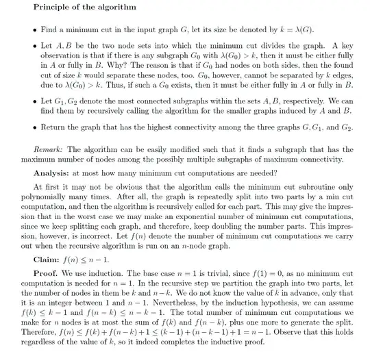

Here is a natural problem from graph theory where the proof and the algorithm are closely intertwined. In my view, one can discover this algorithm only via thinking about the proof and the algorithm "in parallel." The task is this:
Input: An undirected graph.
Task: Find a subgraph with maximum edge-connectivity.
Note: What makes the task non-trivial is that a subgraph can have larger edge-connectivity than the whole graph. Since there are exponentially many subgraphs, it would take exponential time to check all of them to find the most connected one, even though we can compute the edge-connectivity of any graph in polynomial time.
Below is a part of a lecture note about solving this problem. It shows that the task can be solved in polynomial time, using a subroutine that finds a minimum cut (which is well know to be doable in polynomial time). For short, edge-connectivity is just called connectivity, and is denoted by $\lambda(G)$.
Finding a subgraph with maximum edge connectivity
Andras Farago
  • 11,396
  • 37
  • 70
    This is a nice example problem! I might see if I can use it when we do divide & conquer (we typically do that before mincut, but I can give them mincut as an oracle and it will also be nice foreshadowing). In terms of the proof though, if you just want polynomial time, isn't it trivial that mincut is called at most O(m) times (m=# edges), since each time you call it you remove at least one edge? – Joshua Grochow Jan 06 '20 at 08:48
    @JoshuaGrochow Yes, you are perfectly right! Even if the graph has exponentially many edges (it is possible, due to parallel edges, which were not excluded), your argument still carries over, since each min cut call removes at least one full bundle of edges (=all edges between two nodes), and there are at most $n(n-1)/2$ such bundles. However, the $f(n)\leq n-1$ bound is tighter. In fact, it can hold with equality, as shown by the example of an induced path. – Andras Farago Jan 06 '20 at 22:57
