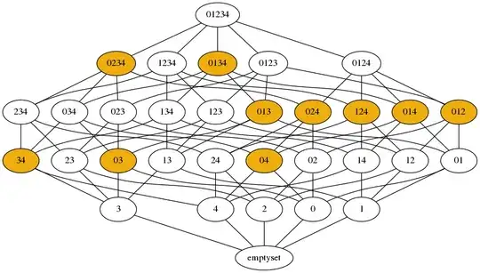

  • My claim does not hold if we do not impose $\phi$ to be monotone. For example, consider the following Boolean function (the satisfying valuations of $\phi$ are colored):not monotone $\sum_{S \in \phi} (-1)^{|S|} = 0$, but $\mathbf{G}_V[\phi]$ does not have a perfect matching since, for instance, $\{3,4\}$ is isolated. The same holds for $\mathbf{G}_V[\lnot\phi]$ by considering $\{0,3,4\}$.

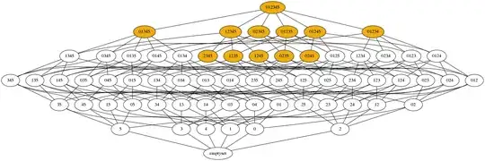

  • There are examples where both have a perfect matching, and examples where only one does. Here is one such example (this is actually the smallest such example):enter image description here $\sum_{S \in \phi} (-1)^{|S|} = 0$, $\mathbf{G}_V[\phi]$ does not have a perfect matching, but $\mathbf{G}_V[\lnot\phi]$ does (trust me). I suspect that, if the claim is true, what decides if $\mathbf{G}_V[\phi]$ or $\mathbf{G}_V[\lnot\phi]$ has a perfect matching is $\max(|\phi|,|\lnot\phi|)$.

  • Do you have a higher definition version of the second image so that we can read it? Also, is $\phi$ the vertices colored in green, or the others? – a3nm Apr 02 '19 at 22:30
  • I updated the figures, thanks. Yes, $\phi$ is the colored vertices (but it doesn't really matter if we consider $\phi$ or its negation). – M.Monet Apr 03 '19 at 14:04
