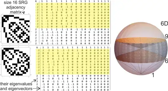

Specifically, looking at eigenspaces of adjacency matrix of strongly regular graphs (SRG), we can give it geometrical interpretation. Below is the simplest example - two 16 vertex SRGs, which locally look identical, but are not isomorphic:
Adjacency matrix of SRGs has always only three eigenvalues (of known formulas) - looking at eigenspace for eigenvalue 2 above (kernel of $A-2I$), it has dimension 6 - of basis written above. Orthonormalizing it (Gram-Schmidt), we get large space of possible orthonormal bases - differing by $O(6)$ rotation, which rotates "vertical vectors": 16 of length 6. Define such set of vectors as $X\subset \mathbb{R}^6$, $|X|=16$ here, and $Y$ correspondingly for the second graph - converting graph isomorphism question into question if $X$ and $Y$ differ only by rotation.
The difficulty is that all these points are in a sphere and recreate original relations: all neighbors (6 here) are in fixed angle <90 degrees, all non-neighbors (9 here) in another fixed angle >90 degrees, like in the schematic picture above.
So testing based on norm and local angles takes as back to graph isomorphism problem ... but geometric interpretation allows to work on global properties like rotation invariants.

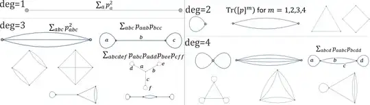

While I couldn't find a way for practical rotation invariants directly working on points (?), it can be done for polynomials (stack). For degree 2 polynomial $x^T A x$, a complete basis of rotation invariants is e.g. $Tr(A^k)$ for $k=1,\ldots,n$. Diagrammatically they can be represented as length $k$ cycle, and we can analogously construct rotation invariants for higher order polynomials (the remaining question is their independence), e.g. each graph below corresponds to a single rotation invariant of degree 1,2,3,4 polynomial:
