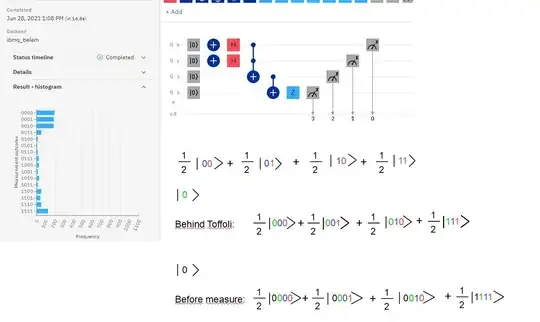

  • I'm confused and would appreaciate any help I can get from you. please look at my setup I have q0 and q1 passing an "H" gate then the toffoli with an !0> - switching !0> + !11> to !111> Same with the next gate When running I see the expected results. But what drives me nuts: From the explaination in the article I would understand my setting also as a ^(q0 & q1) Then the result should show me "00" as solution for q0 and q1. What's wrong with me idea??? Thanks a lot! -Jerry – jerry Jun 28 '21 at 12:57

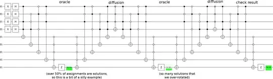

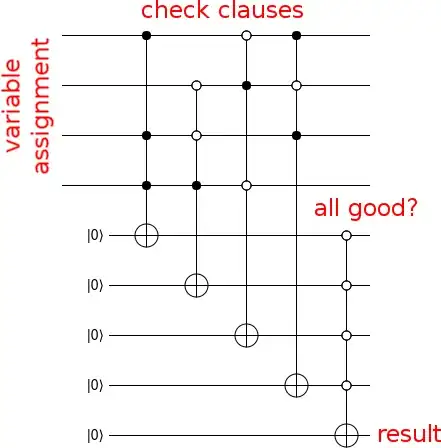

Now make a circuit that computes whether the input is a solution, like this:
solution checker

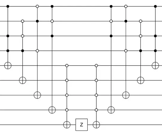

Now, to turn your circuit into an oracle, hit the output bit with a Z gate and uncompute any garbage you made (i.e. run the compute circuit in reverse order):
oracle circuit
That's all there is to it. Compute the predicate, hit the result with a Z, uncompute the predicate. That's an oracle.
Iterate diffusion steps with oracle steps, and you've got yourself a grover search:
grover search
... although you should probably pick an example with fewer solutions, so the progress is gradual (instead of rotating along the start-state-solution-state plane by more than 90 degrees per step as my example is).

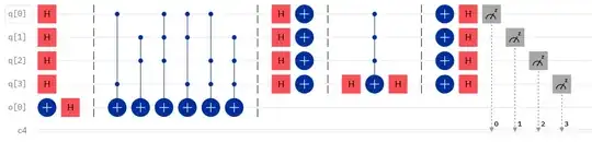

You can also get a solution which uses only one ancillary qubit (but relies on NOT gates with multiple controls), by getting your input to algebraic normal form (e.g. with Mathematicas BooleanConvert).
For example let us use the 2x2 "Sudoku" example in the Qiskit book (i.e. a 2x2 grid of 1bit numbers where in each column and row there should be no duplicates). Numbering the entries like
$$ \begin{matrix} x_0 & x_1 \\ x_2 & x_3 \end{matrix} $$
our function is
$$ f(x_0, x_1, x_2, x_3) = (x_0\oplus x_1)\land(x_2\oplus x_3)\land(x_0\oplus x_2)\land(x_1\oplus x_3) $$
Either by hand or with computer help, we arrive at
$$ f(x_0, x_1, x_2, x_3) = (x_0\land x_3)\oplus (x_1\land x_2)\oplus (x_0\land x_1\land x_2)\oplus (x_0\land x_1\land x_3)\oplus (x_0\land x_2\land x_3)\oplus (x_1\land x_2\land x_3) $$
As you are looking for an operation that gives you $|x,y\rangle\to|x,f(x)\oplus y\rangle$, we can just apply the terms one after the other. And as each term is just an AND between multiple variables, this can be written as a controlled not gate, where the not operates on $y$ and has a control for each appearing $x_i$. For our example, this looks as follows (q is $x$ and o is $y$)
oracle
Implementing one Grover iteration, we see that it yields the two solutions
$$ \begin{matrix} 0 & 1 \\ 1 & 0 \end{matrix}\quad\text{and}\quad \begin{matrix} 1 & 0 \\ 0 & 1 \end{matrix} $$
as expected.
circuit
hist
