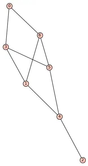

Update (Jan 2017): The conjecture is false, as shown by this counterexample found by Eryk Kopczyński:
counterexample with 7 vertices
The question in the title (Is it NP-hard to find a small decision tree for a monotone boolean function?) remains unanswered.

  • Your CNF is entirely dual and doesn't change the problem at all. Eryk's counterexample still works. – Radu GRIGore Jan 29 '17 at 15:23
  • Sorry if I am stupid here but could you elaborate your counter-example a bit by giving the graph. Moreover, it seems to be a confusion as decision-trees cannot reuse computation contrary to the DAG you have given in the counter-example. If you are talking about decision-diagrams (also called FBDD) then I agree that your conjecture is wrong. Please clarify (the paper of Boadlander et al. you give is for decision-trees, with underlying directed trees). – holf Jan 29 '17 at 18:58
  • The counterexample above is a graph. (It obviously isn't a tree, so it can't be a decision tree.) – Radu GRIGore Jan 29 '17 at 19:07
  • Sorry my bad. I misunderstood. Thanks for the clarifications. – holf Jan 29 '17 at 19:16
  • @D.W.: 1. The question has always been what the title says, so it is unanswered. 2. The body showed my attempt to answer the question, so it is not mismatched. It's just that now we know that my attempt is doomed to fail. So, one option would be to remove any trace of it. – Radu GRIGore Feb 01 '17 at 05:00
