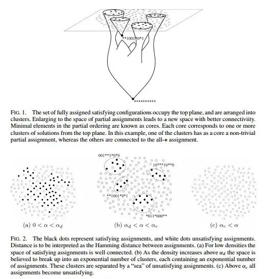

Unfortunately it's behind a paywall so I'm unable to view that paper but from reading the abstract it bears at least a superficial similarity to some "cartoon pictures" that I've seen on survey propagation and it's use to solve 3-SAT. Here is a "cartoon picture" from Maneva, Mossel and Wainwright's "A New Look at Survey Propagation and Its Generalizations"
Here $\alpha_d$ is the value for the density transition and $\alpha_c$ is the critical threshold value ($\approx 4.2$ for 3-SAT).
It'd be interesting to see if the locations of the different fractal regions reported by Ercsey-Ravasz and Toroczkai correspond to the different critical thresholds noticed in survey propagation (or if I'm completely wrong and the similarity really is superficial).
