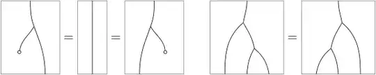

nLab goes on to say, that monads can be represented as string diagrams. Here are
The axioms for a monad - could be represented in terms of the >>= operator in a language like Haskell - are represented in terms of string diagrams.
Then, can a computer program be represented in terms of these diagrams?
The answer is actually yes, but not through the connection you are describing. In fact, the string diagrams you mentioned live in the 2-category $\mathbf{Cat}$, whereas programs live in the category induced by the programming language. A little more on this topic may be found in the answers to this cstheory.SE question.
