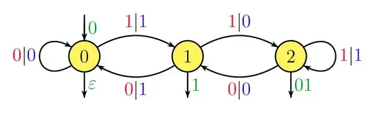

I am not sure whether this is directly relevant to the question, but the following elementary result might be of interest. Given a fixed natural number $k$, the operation $n \to kn$ can be realized by a sequential automaton, provided that $n$ is written in reversed binary notation (that is, Least Significant Bit First). The number of states of the automaton is $k/2^r$ where $2^r$ is the largest power of $2$ dividing $k$. For instance, the operation $n \to 6n$ is realized by the following automaton. enter image description here
For instance, $185 = 1 + 8 + 16 + 32 + 128$ and $6 \times 185 = 1110 = 2 + 4 + 16 + 64 + 1024$. Thus, in reverse binary, $185$ is written as $10011101$ and $1110$ (bad choice, I know...) as $01101010001$. Processing the entry $\color{red}{10011101}$ on this automaton gives the path $$ \xrightarrow{\color{green}0} 0 \xrightarrow{\color{red}1\mid \color{blue}1} 1 \xrightarrow{\color{red}0\mid \color{blue}1} 0 \xrightarrow{\color{red}0\mid \color{blue}0} 0 \xrightarrow{\color{red}1\mid \color{blue}1} 1 \xrightarrow{\color{red}1\mid \color{blue}0} 2 \xrightarrow{\color{red}1\mid \color{blue}1} 2 \xrightarrow{\color{red}0\mid \color{blue}0} 1 \xrightarrow{\color{red}1\mid \color{blue}0} 2 \xrightarrow{\color{green}{01}} $$ which gives the correct output $\color{blue}{01101010001}$. The type of sequential automaton I am using here was called subsequential by Schützenberger: as you can see there is an initial prefix (in green) and a terminal output function (also in green). For more details how this sequential machine can be computed in a systematic way, see this link.
