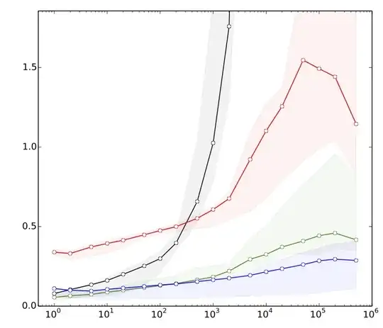

Here is a sample implementation and benchmarks:
Here is a plot of running times (for $n \approx 2\cdot 10^6$):
  • Blue = sorting + post-processing, $O(n \log k)$.
  • Green = maintain two heaps, $O(n \log k)$, implementation from https://github.com/craffel/median-filter
  • Red = maintain two search trees, $O(n \log k)$.
  • Black = maintain a sorted vector, $O(n k)$.
  • X axis = window size ($\approx k/2$).
  • Y axis = running time in seconds.
  • Data = 32-bit integers and random 64-bit integers, from various distributions.
