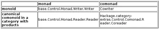

What about Reader and Cowriter? Reader is adjoint to Coreader, as explained in the definition of Coreader, see link above. Similarly, Cowriter is adjoint to Writer. I did not find a definition of Cowriter, so I made it up by analogy shown in the table:
alt text

The question is that the adjunction in $C$ relates functors, not monads. I do not see how the adjunction implies "Coreader is a comonad" $\to$ "Reader is a monad" and "Writer is a monad" $\to$ "Cowriter is a comonad".
